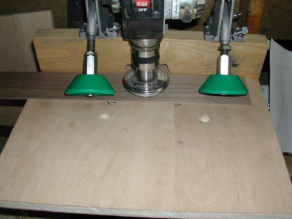

Terry,
Here you go...

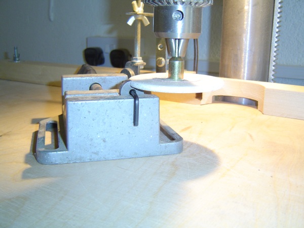

OK, here's how I sharpen my WSP. I do it just as SM say in their instructions! Mount the stone in the drill press, put the cutter in a press vice with a bar through the hole and with the press off, level the cutter in the vice as shown in the photo, so that the stone runs in evenly to the end of the recess. Remove the vice then run the press up to speed (fast as it will go) then feed the cutter in and grind all the way in until a small burr appears along the whole edge of the cutter. Take it out of the vice and just dress the back edge of the cutter with a stone to remove the burr. Screw back into the planer. Repeat twice more! I sharpen after every major job.

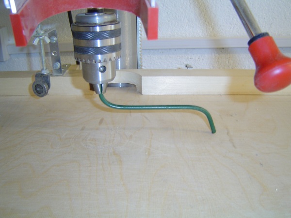

The others are right when saying that the key to success with the planer (apart from keeping it sharp) is to have the table level this is how I do it with a bent piece of 4mm covered steel bent to shape. Rotate the chuck by hand and level the table, either with the adjusters or shims between the wooden and iron tables.

ColinColin S38995.3862962963

Colin's photo shows the bent wire( boy that's really big "wire") method to check level table. As I recall, Al Carruth swears by the Wagner and has posted great use and sharpening information. Maybe someone should ping him(One ping only;one ping)MT

[QUOTE=mikev] Tracy, are those whelliething a majigs spring loaded or just weighty. Where did you get them? I thought I remember someone using a rollerblade roller also. I just hold down with my hand, maybe thats not consistent enough.Mike[/QUOTE]
Mike, these are anti-kickback rollers that I got from woodcraft. You can get them HERE. They are spring loaded and apply pressure downward. Make sure you get the green ones, as they allow the wheel to move forward and backwards. The yellow ones only go one direction. This has been a great thread about sharpening. I really like seeing how Colin did that, can't wait to try it out!
